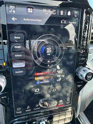

What does the propulsion screen look like. Is the HP still go up to 1,000 or is it neutered to 520?
I just looked at that as well and it now shows 550 lb ft.

It appears that after about 24 hours, the issue does seem to resolve itself. When I called Uconnect about all the issues I was having, especially regarding suspension changes (it felt MUCH softer than usual) they said it would not have changed that. I usually roll around with Sport suspension (with the patch not allowing suspension changes) had actually changed to street. So, it DOES change the suspension settings, they just weren't aware that it had.
It did not resolve all of the RHO graphics that are incorrect. At least it did not on my truck. Messaging @RamCares now.

A hard factory reset via the Vehicle-->Settings-->Factory Reset option can make everything go back to normal. I had to do it two times since the RHO drive mode diagram came back after the first reset.

Thank you all again for following up with us here and in private messages. The incorrect graphics are currently being further investigated — if anyone else would like to send us their VIN to be included in the list, we will happily add you.
Please note that while we can't guarantee timing to further update you here about the specifics of the investigation, we will continue to post out whenever possible.
Again, we appreciate everyone's willingness to provide us with the information, and we hope to have good news to report back soon.

I called RAM and after 9 redirects, 8 agents, and 4 different departments, they couldn't give me a solution. Very disappointing. They should have a way to roll back to a previous version. Today, after several months of that update, there is no answer, and I noticed the Boost Gauge is missing from the Gauges Page. That ugly RHO engine is still on my screen. This is not serious.
I called RAM and after 9 redirects, 8 agents, and 4 different departments, they couldn't tell me an answer for the fu***ing mess they did. I'm very pissed off with a damn update that I didn't request, and they can't roll back to a previous version (easy solution could be a previous firmaware update without having to go at the dealer to leave the truck for 3-7 days just for a factory reset "they said"). Today, after several months of that update, there is no answer, and I noticed the Boost Gauge is missing from the Gauges Page. That ugly RHO engine is still on my screen. What the hell!!!! You pay $95K for this? This is not serious.
