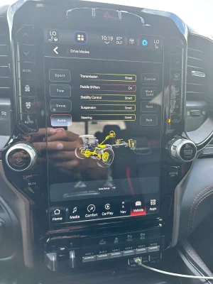

I thought I got lucky and did not get the update due to the paused updates per RamCares. Unfortunately today my truck wants to identify as a Hurricane
Welcome to the hurricane club. I’m thinking this is a marketing strategy to insensitive TRX’s owners to sell their V8 and get that crappy engine. 😆🤣

My understanding is that two update types are involved: core Firmware (FOTA), which was paused, and Application (AOTA), which was not. The AOTA is the direct cause of the RHO graphics issues, incorrectly pushing faulty app information. Since this problematic AOTA has now been sent to vehicles on all firmware versions, it's highly likely that this issue will eventually affect every TRX.
