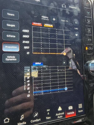

Well this is not encouraging. @RamCares what is happening here?

Hey guys, I have seen a few posts on Facebook about the screen going black and unresponsive. I thought I read that disconnecting the battery for 10-15 minutes could help, but someone told me that disconnecting the battery could cause issues with Active Damping Suspension, ESC, loss of adaptive memory, and so on.
So, my question is: Should I always use a memory saver device plugged into OBD-II when I am working with the battery?

Mine just started updating without approval in the middle of a long Interstate road trip on Sat! F'ing bullsh#t as it locked out the screen until it finished and then all the functions (climate control, media, etc) were broken for over an hour until the next stop when I was able to shut the truck down long enough for it to fully reset. Everything appears to be back to normal now but I did have to reset my shortcut and favorite screens.

That message went away after disconnecting the battery.
Did you have any issues after disconnecting the battery? like calibration or something? How long?
This is what piss me off, why does an update have to go without user approval and in the middle of a trip? Just imagine this fucks something, and you have to cancel your trip. One more time, well done RAM!
No issues, I just disconnected the negative terminal for about 20min.
Also when I installed the Brawler Fab battery box, I had the battery out of the truck for a few hours and no issues after connecting it back up.
Only early 2021s had issues losing the suspension calibration after the battery disconnect.
FWIW pulling interior fuse F44 will kill power to the radio the same as disconnecting the battery.
