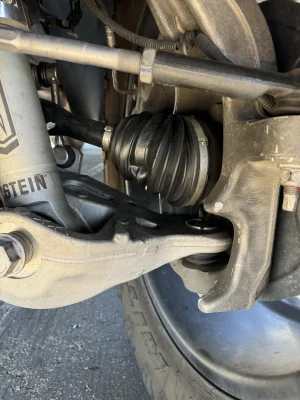

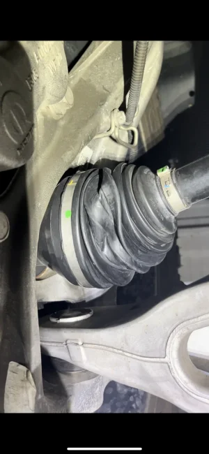

Sure thing... the image with the small crinkle is what it starts off as... then it turns into the second image... then it just tears and grease everywhere... ridiculous.
The small crinkle is what I have right now.
The larger crinkle was on my previous one that completely tore after about 1000 miles after that image.
Known issue due to crappy material. Nothing to do with a 1.5 perch collar level kit.
I've had the small crinkle and it's gone away. I also had the large crinkle and it lasted like 10 minutes and then destruction haha. the large crinkle was 100% a defective axle. Only lasted about 150-200 miles of street driving and 7 minutes of light offroading before it imploded
Yea, on the large crinkle axle it started off as the small one... then it got worse.... then like you said imploded... the very strange part is that it only happens on the drive side boot.... the passenger one is the original one... yet... both axles are the same part number... so I'm confused.
Hah! mine was the driver's side too that imploded.
