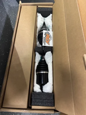

They are in! Getting the install done 10/24. Let’s hope they work out. My stock driver side is shot again. I don’t understand how it’s possible. I have the same factory 35” tire diameter with a 1.5” level. As basic as it gets. Hopefully these RCV’s do the trick.

any visual difference from the stockers??
Definitely different materials, the main shaft is different (no neck down), the splines are different. Everything looks better quality as you would expect from RCV but none of that is the issue w/ the stocks. The issue is the boots tearing. The boots are definitely different on the RCVs. The stocks are more of a hard plastic type material rather than rubber. The RCVs are way more compliant so hopefully can take flex angles better without permanently deforming like the stocks. Will keep everyone posted after the install.
