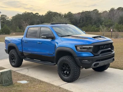

I am Eibach Pro springs (1.6") all around, 37's tires, Foutz Heim Panhard bar, Hellwig anti sways.
This is what has me hesitant to install the 1.6 springs or any spring in the front. Still have them laying around in the box for almost a year now. Installed the HD rear springs though. No issues.

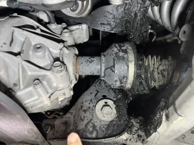

First Boot tear after 22,000 miles on my springs. Warranty is covering with no issues… but… may be time to start thinking about an aftermarket upgrade.
