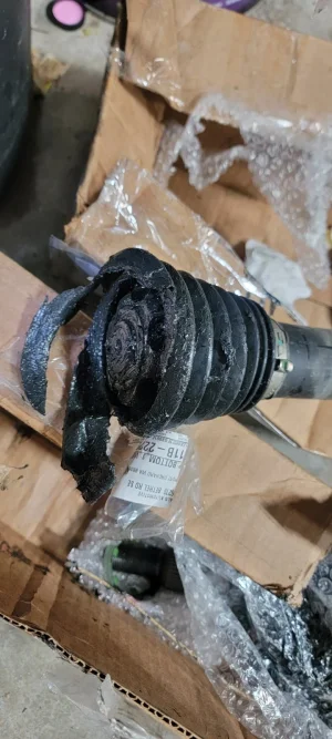

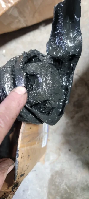

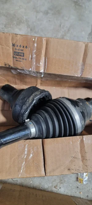

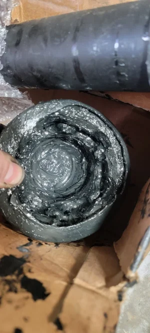

Here are mine, it is breaking the cage and blowing apart. I have 3 choices.
Sell Truck
Put deposit down on the axles being built.
Remove lift and run stock tires.
Last axle that broke I was going up a hill on way home and was on the throttle hard and the front left let go. With the lift and heavy throttle it is pulling the axles apart. They are too short.

Curious - which lift do you have front & rear? Also tire size?
