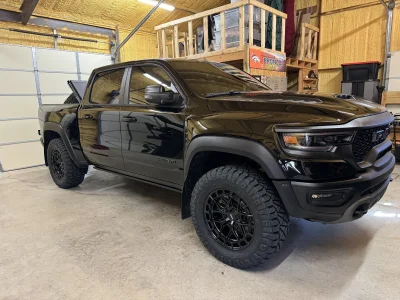

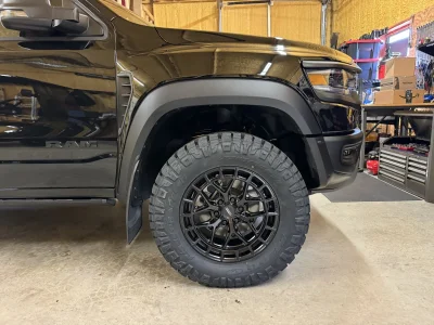

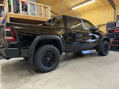

Just mounted some 325 60 20 Ridge Grapplers on 20 x 9.5 Vossen HFX-1. Loving the look! No rubbing even with the mud flaps on.
In case anyone is curious, I got a extra 1/2 inch in ride height running the tires at 38 PSI. Mounted, the tires measured almost an inch taller than stock.

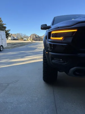

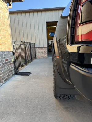

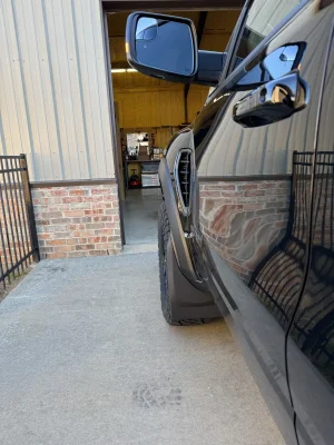

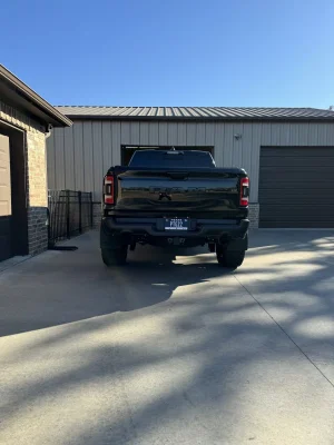

Any pics down the side of your truck showing "poke"? Curious on the offset/backspacing and what the resulting stance looks like from the side/front.
Looks great from those pics!
Offset is +15 so you get just a little more poke than with the stock wheels. They are still under the fenders though. I honestly think that this is the perfect combo for stock height if you aren’t looking for a super aggressive stance.
