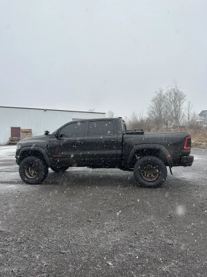

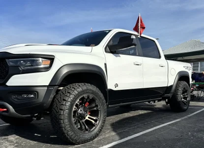

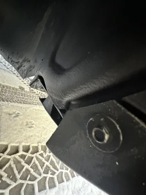

New look for 2024 threw on the new Vossen hfx-1 20x10 -18 offset wrapped in 37x12.50 ridge grapplers. Minor rub at full lock on bottom fender screw on drivers side with the 1.6 eibach front springs and had to lose my weathertech mud flaps 😔 but overall very happy. Thanks to @Nick797 for the wheels and tires and @Johnny@JustBoltOns for the eibach springs, Vossen lug nuts and wheels locks!
damn they look good!

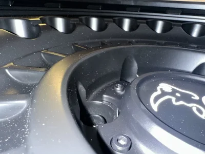

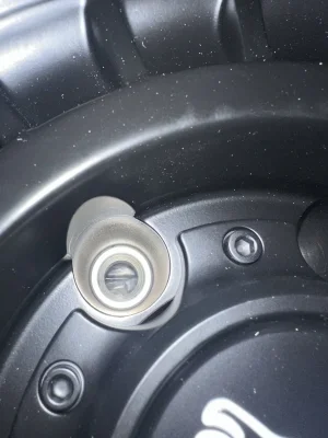

The wheels and gorilla lugs (K6TS-14150BGR) are both conical seat. As you can see in the pics its about .5 recessed from the wheel and i couldn't find any lug nuts that are longer than 2 inch. You think this would be fine?

I think the general rule is to have at least the same length of thread engagement as the wheel stud diameter.

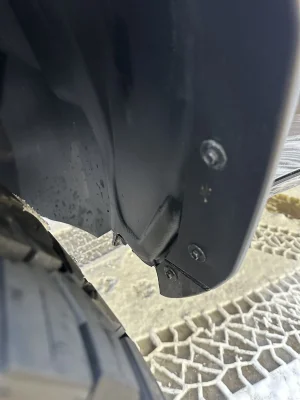

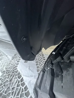

Had to trim a good bit, it still touches at full lock over bumps but that’s only if I’m cranking on the wheel. I’d say you’d end up needing to cut more on the stock suspension, this is with the 2.7 Eibach Springs.
That's interesting. Didn't think it would rub at all with the 2.7 up front.
