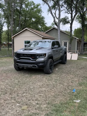

For reference this was my old setup with -18 offset wheel wrapped in a 12.5 35 inch tire. Should be a similar poke, no trimming required

What’s size wheels are those? I’m good with this look just want a little poke nothing extravagant. How did the truck drive and did you have a leveling kit
22x10 wheels. Truck drove great. Could not tell a difference between those and the stock beadlocks. Stock height. Did not want to risk the cv axles with the offset+lift
