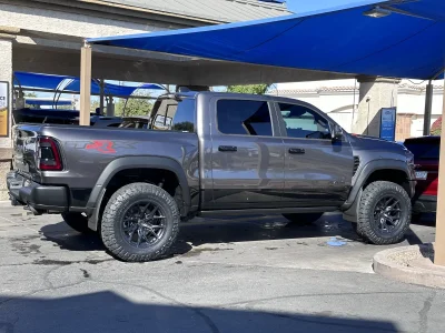

Do you want wide tires like oem which i think are close to 13” or 13.5”? If you want the tire to be wider than the wheel i wouldn’t go more than a 10” wide wheel.
I think u guys are right. 22”x10. Looks like a big rim with some sidewall and from this pic looks like it stays under fender.

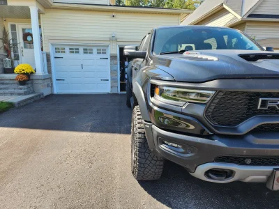

I have 20x10 with -18mm offset and basically 13.5” wide tires and this is what it looks like.
It definitly sticks out some. If you want it to still be under the fender you might want a zero or +1 offset wheel. Like I said there are not unlimited options so you have to settle for what you want with as close to what you want.

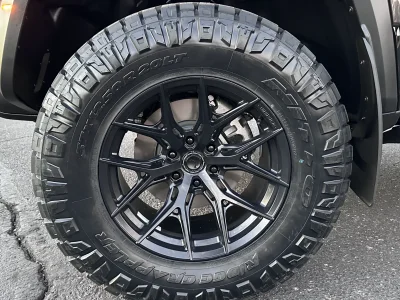

Just ordered these yesterday. Should have them on the week of thanksgiving. New release from Vossen.
Vossen HFX-1 Satin Black
22x10 et-18
Nitto Ridge Grappler 35x12.50R22
Looking forward to seeing those on the truck. That style of wheel looks good on these trucks.
Any trim needed with the -18 offset?
Yes, on both sides the front/lower portion of the plastic inner liner about an inch and some massaging (heat gun) on the drivers side - rear inner liner near the bottom last screw. Still have very minor rubbing when the wheel is turned left at full lock. I will still be working on this in the near future to hopefully eliminate all rubbing.
BUT the truck looks really awesome. I really like some poke.
