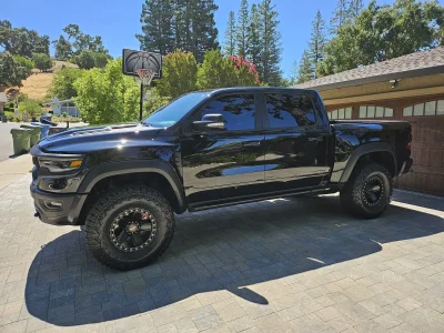

Finally got around to fixing stock setup
Lift: 1.6" Eibach front 1.5" Eibach rear
Wheels: Custom forged beadlocks 18x9 +12 offset
Tires: 37x13.50R18 Falken Wildpeak R/T01
Rubbing: None (still need to flex it out)

Fantastic. Me want.

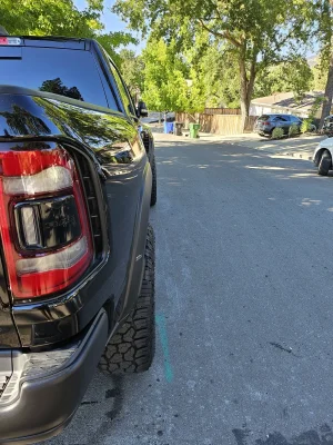

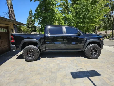

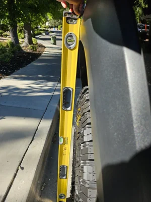

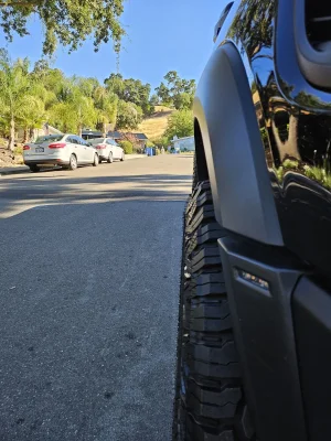

Let’s see some side profile shots to see the poke -if any!
No poke unfortunately. Still pretty flush.

Thanks, ya I guess it does a little bit. Wish I had gone a little more aggressive on backspacing.

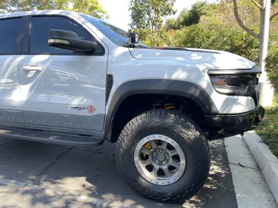

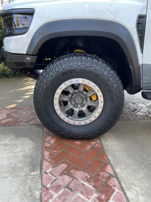

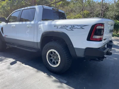

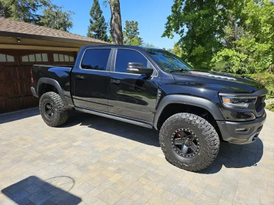

After much research and discussion with multiple parties I pulled the trigger and ordered the INNOV8 Racing G500 wheels in 18X9 with a 0 offset.
After thoroughly researching the tires available I installed the Falken Wildpeak A/T3’s in 37/12.5/18 .
The ride and handling is vastly improved over the OEM Goodyear’s and the tires are quiet and ride very smooth.
I have no rubbing at full lock right and left and the set up is only slightly wider than the OEM setup so wheel well clearance should not be an issue at full compression.
Jason at INNOV8 Racing was fantastic to work with and these are the wheel specifics.
G500 18x9 Simulated Beadlock 31.6 lb
Rock-R Ring 3.3 lb, the alternate style tech light rings are 1.6lb
Hardware Kit .5 lb
Center Cap .58lb
Total Weight 35.98 lb
Their wheels are forged monobloc (1 piece) 100% made in the USA!
