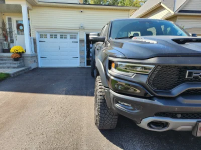

What level or lift springs are you running?
I selected the Eibach 1.6” springs in front and The Foutz Motorsports 3/4” spacer in the rear!
I also installed the Fox Racing bump stops from Foutz Motorsports in the rear1

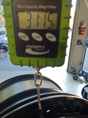

My 18x9 beadlocks are 31.5lbs. (with hardware).

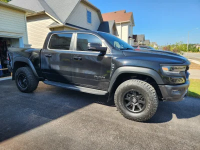

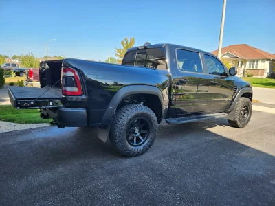

Looks good. 18x9 0 offset is the perfect size wheel for the TRX. Flush to the wheel well with no poke. Too bad the selection of wheels that size and with that offset that will clear the TRX brakes is so limited.
Yes, it's a shame. These weren't exactly what I had in mind but I will rock them for now.

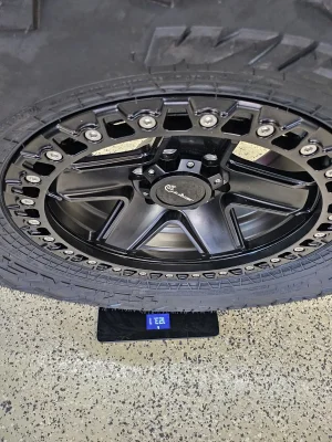

KMC 18x9 +0 with Falken 37x12.50 weighing in at 104lb. Ride is much better than my BFG 37's on 20" wheels, and it took less than HALF the weight to balance this combo.

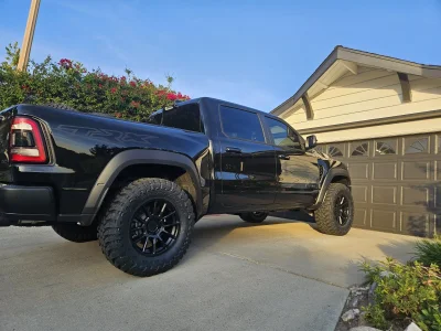

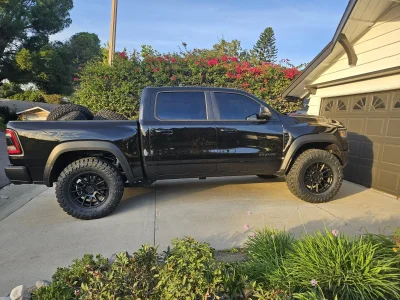

Rim size isn't your worry. It would be offset that sticks things out or in. Kinda counter intuitive. Negative offset sticks it out a lil, positive brings it in. It's kinda confusing to explain, plenty of YouTube videos. I just did 37"x13.5x20 on my rig. Rims at 0 offset. Slight rub completely stock. Will be throwing springs later to lift it a bit
