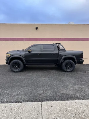

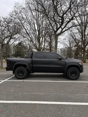

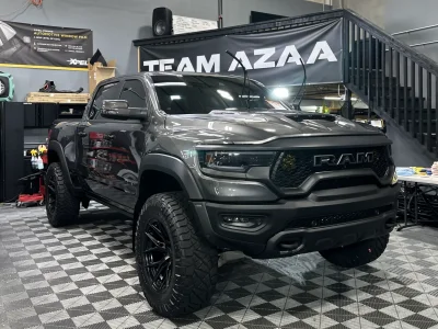

Current set up are method 317s 18x9 0 offset with 37x12.5r18 recons on stock suspension (very minor rub at full lock on drivers side). Loved the look but I got bored after a year so looking to switch it up. This thread is huge and not sure if I missed someone with a -18 offset on 37s if so please post some pics. My current set up will be up for sale soon if anyone’s interested.
Current set up

awesome thank you! Love the set up was thinking of going 1.6 in the front do you get any rubbing on the 2.7?
Very minor on the drivers side at full lock on the lowest screw head. Still working on a remedy. I went with the Eibach 2.7 upfront as I didn’t want a lower nose rake.
awesome thank you! Love the set up was thinking of going 1.6 in the front. Do you think I'd be good or do i need to get the 2.7?
I went 2.7 and love it.

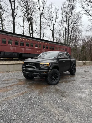

New look for 2024 threw on the new Vossen hfx-1 20x10 -18 offset wrapped in 37x12.50 ridge grapplers. Minor rub at full lock on bottom fender screw on drivers side with the 1.6 eibach front springs and had to lose my weathertech mud flaps 😔 but overall very happy. Thanks to @Nick797 for the wheels and tires and @Johnny@JustBoltOns for the eibach springs, Vossen lug nuts and wheels locks!

Gorgeous set up!.
What lug locks did you get?
New look for 2024 threw on the new Vossen hfx-1 20x10 -18 offset wrapped in 37x12.50 ridge grapplers. Minor rub at full lock on bottom fender screw on drivers side with the 1.6 eibach front springs and had to lose my weathertech mud flaps 😔 but overall very happy. Thanks to @Nick797 for the wheels and tires and @Johnny@JustBoltOns for the Vossen lug nuts and wheels locks!
The new HFX look great. Love to see another out there.
