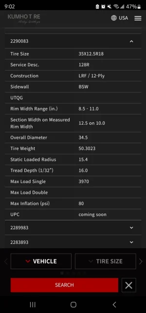

Honestly I think if I could change anything, getting the BFG's the Raptor R has makes the most sense from a 37" tire perspective. If you want 37's and don't want to lose performance...those only weigh 63lbs. That being said, unsure how they perform on dry pavement with 1100 lb-ft of torque.
Raptor guys who look for a light Tire are getting the Goodyear MT.
Only thing is the BFG from the raptor is a 17 inch wheel, which doesn't fit on the TRX. The 37x13.5r18 that fits the TRX is 75lbs.

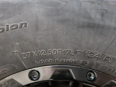

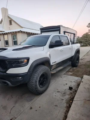

They fit with a little effort

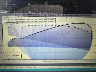

I didn't know he posted anything. Yes in fact I just picked it up 3 hours ago. It dynoed 1063 hp & 1050 torque at the wheels on 93 so I guess it would feel similar to your 1100 hp truck. Amazing enough the truck gets 2mpg on the highway better than before. I did 17.2 on the way back running around 70. I'm guessing that's due to a blower with less drag?? Start to finish he had the truck done in 2 1/2 weeks with the holiday.
There's so many Ripa haters on here and this is my 3rd truck with him and I haven't seen anyone on here get what I got as timely as I did with the net results I did on the first shot. Steve at Ripa absolutely knows his stuff.
We did a 426, cam, ported heads, whipple, chiller, headers. The only way I could get more power was to remove the blower and do straight turbos (est + 150 hp) however it requires a stall converter and because I use the truck for towing I didn't want to mess with the transmission. I regret it. The truck has way more power than traction for sure. I didn't do any timed runs runs with it. Basically there just a function of hp but how you set up the truck and how experienced your at launching it so to have me do it and post numbers is pointless. I'm guessing done right it will run in the 10's
