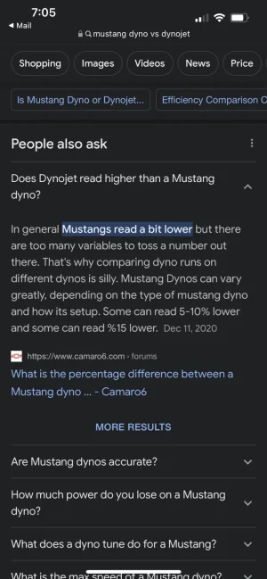

weird….every person I’ve spoke to says a Mustang dyno gives lower numbers than a dynojet.

Not 300 horsepower lower.
I never said it did. All I know is comparing dynos of different types (roller vs hub or rear wheel drive vs AWD for example) ran by different people on different days with different weather conditions is what it is. Which is a good estimate but it’s not apples to apples. That was my only point. And I thought 10mpg was just saying the same but maybe I was wrong….dunno. I’ve read just how well they are tied down or the difference in tire compound or size can make a huge difference. I I frankly don’t recall reading anyone talking about this 300hp difference. I could have missed it and I have no interest to read back through this thread.
