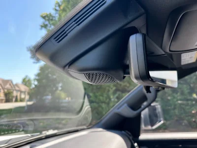

Possibly the coolest and easiest dash cam install ever
Here is my 2023 TRX, and here is the product info from their amazon listing. Their photo shows my truck as model B.
