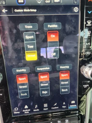

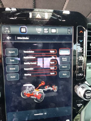

Custom mode setup screen shows trans is on Street, custom main screen shows trans is on sport. You can change it to tow or street but it always defaults back to the street even though the transmission actually does change on the main screen

Thanks so much for tagging us. We've been in contact with the software team and shared the feedback and pictures that have been provided here. If you received the FOTA update to U29.44 and have noticed an issue for more than 48 hours, we would like to provide your VINs (and any videos or screenshots) back to the team. Please private message us with your information if you are still having an issue.
