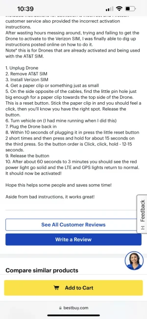

If you can gain access to it then its not too hard to do yourself. You can order the Verizon sim online. The how to’s are online but can send it to you if you wanted to try it out

So buy this swap it out? anything to do on the application or subscription side?
Most of the time you don’t need to if done correctly and the subscription is already active. At worst you call the drone tech line and they force it through.
If its a drone x1 max then it needs to be popped open carefully and then unplug the little battery. Its attached to the top half so can’t just pry it apart.
