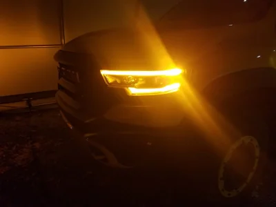

You’re simply using alfaobd to change the DRL lamp location from the low beams bulbs to the turn signals, which are amber. Then disable the signature lighting (which are the white strips above and below the headlamps and are on anytime the truck is running).
This is the amber that AlfaOBD... yes it is the signature lighting. Not the low or high beam.

So, the upper and lower strips have two sets of LEDs in them- white and amber. Obviously the amber serve as the turn signals, and DRLs when configured that way. The white leds serve two purposes- signature lighting when the truck is running without the headlights on, and parking lights when the headlights are on.
If you don’t turn the signature lights off, they will be on in the background when amber DRLs are on. It will be hard to see because they are dim as signature lighting and the amber overpowers them, but they will still be running in the background.
