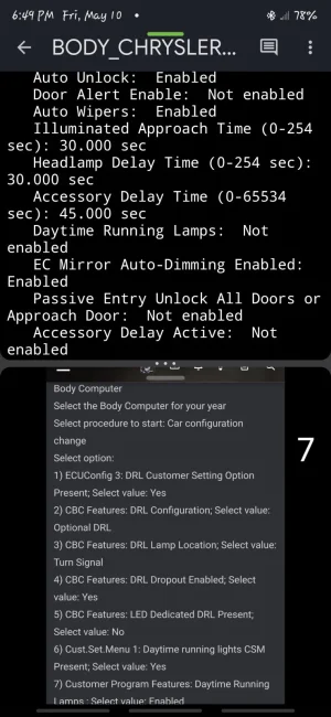

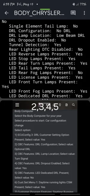

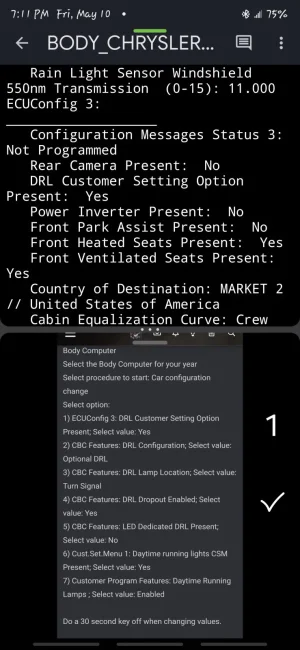

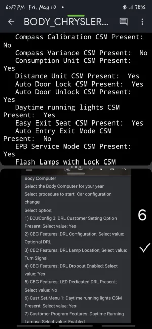

So when I was first thinking about doing this, I read something from you that said do a back up with alfa which I did. I think that's where my confusion is, my DLRs were not on in the head unit when I did the back up so 2,3,4,5, and 7 all needed to be changed. I just enabled DLRs, so all the options but the 2 should be good? I will obviously check them before and redo the back up, but it sounds like that would do it and I only change the 2. Thanks for all the info!
