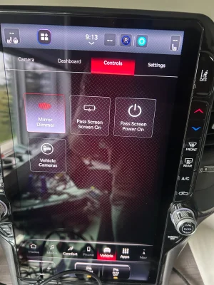

I want a full screen mirror to run highway radar and other non AA apps.

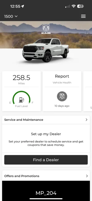

also wanted to note. After the uc5 clone install. My ram app is still reporting the current fuel level and mileage. The only thing that has stopped working is the health reports.

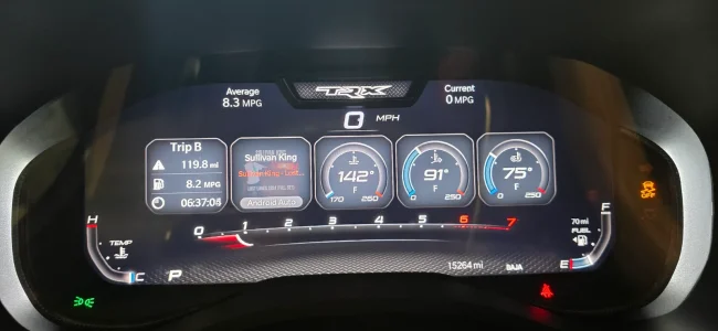

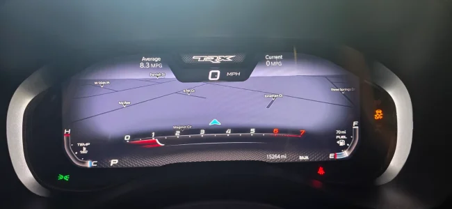

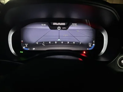

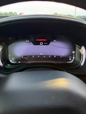

Got maps and tiles working in the digital cluster today! Thanks @skuppy069 for the easy plug n play kit! Thanks @OnTheReel for the radio module and for helpful guidance today!
Also to note I have an IGLA and a Tazer DT (unmarried) and this kit worked as intended.
Thanks again boys 🍻
Thanks again boys 🍻
Glad it’s working !!

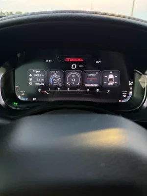

Is there any way to trx sport and Baja pages on a non trx ram digital cluster I would love to get those on the digital cluster

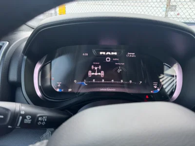

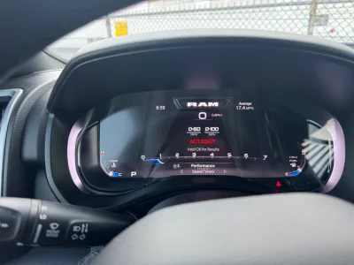

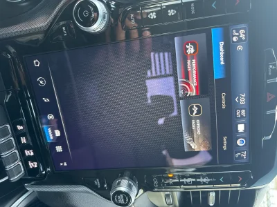

The only things I’ve been able to turn on are,Off Road and Performance pages.

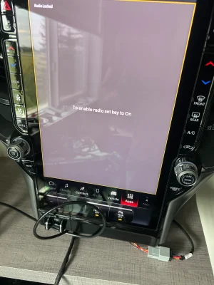

Great to see it. Of course it figures since I got impatient and sold my 14.4” screen awhile back. When it came down to it 2k in my pocket was better than a screen I couldn’t use for anything. 😂
Do you think the trailer brake, steering and aux switches could be made to work too since all of those are specific to that screen?
At this early point I have no idea what the outcome will be to be honest .
I will keep stabbing at this when I get some time on my hands .
Right now my goal is just to figure out the ignition messages .
