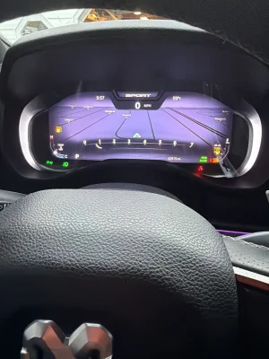

During this modification I also swapped out the Instrument cluster to a 2023 model. I was happy with everything, but came to realize without the BCM or the Bypass cable installed, I was not going to see any maps on the display. I had driven about 500 miles with the digital display and though I liked the look, I still missed the analog gauges. Understanding that I can choose an analog style in the digital display, it just did not look quite the same. At the time I was going to place the by pass harness into the system to display the maps on the digital display I was in need to bring the truck in for warranty work. Not wanting to give the dealer any reasons to void the warranty I had to swap back to the analog and perform the mileage correction.
Please note when doing the instrument cluster swap, change the instruments to read kilometers and record the values for the future updates. Updating the milage on the analog screen through ALFA OBD II requires the changes to be made in kilos. Recommend recording all distances in kilos and adjust using kilos. I was able to get within 1/10th of a milage.
Once I had reinstalled the analog gauge cluster, I noticed that when using Apple Car Play and Apple Maps, the turn-by-turn directions are now being displayed in the EVIC center screen, as well as on the HUD. Unlike the UC 4 system I never seen Apple Car Play / Apple MAPS show up in the EVIC. I tried WAZE and Google Maps, but they did not show up. Note as well when using Apple Maps and WAZE at the same time, the Turn by Turn did not show up in the EVIC.
Because this feature is working, I am not sure I want to go back and install the digital display, well not until they can figure out how to resolve the Milage correction.

Any idea why I get two dash marks where it is supposed to indicate the gear? I have done so much research on this with no results.
Yeah non TRX. I had spoken with him about that and he hasn’t been able to crack the code on the double dash, just if it indicates P. Was just hoping someone else may have an idea
With Alfaobd performance indicator
I don’t think that fixes it as another member has that set already and no differences.
Non TRX truck that is but worth a try for folks if doesn’t show up the PRND .

I fixed mine everything worked great
Sounds good .I know another member has it set and still no dice so very interesting but his a 19 truck and maybe those bits don’t broadcast .
Either way thank you for this and I will give it a try when I get my cluster in and will get a DT to mess with .

Short video showing everything working
  • 78182607487__B2D3F11C-B87C-477F-97B4-C457139DD5AD.MOV
    5.8 MB
I order for maps to come out you a 23 bcm and 23 radio module the dealer will flash the 23 module I’m in 22 bighorn I told I was just storing parts
Good morning, how did you transferred the mileage? Did you bought it from infotainment?
