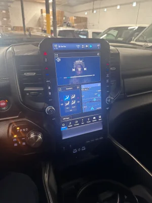

Shout out to @skuppy069. He finally got me in the game with the 14” screen and helped work through some bugs. He is a class act and a wizard! Appreciate the work you, and @OnTheReel have done to make this possible!
Thanks for the kind words amd thanks for working with me with some of those bugs .
