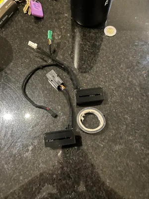

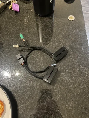

Hare is a pic of the two modules .
Half roll of electric tape as a reference for size .

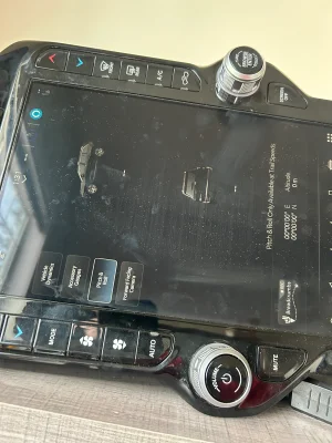

I have a Jeep radio module on my test bench and seems to working the same as the Ram radio .
The only thing I have noticed is the pitch and roll has a pic of a jeep .
Probably just a glitch of your test bench. When I was screwing around with these, I added the off road pages to my BCM (not usually equipped on TRX since most the data is redundant on the performance pages). Everything is Ram. The front sway bar disconnect is obviously not valid for a TRX but the rest of the info works and is all Ram as it should be.
The breadcrumbs feature on your page also goes away when installed into another vehicle. Doesn’t even work on my actual Jeep.
