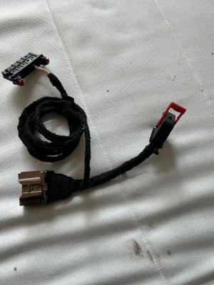

I just listed a 23 digital cluster in the classified section if anyone is I interested in this mod.
I will throw in a plug and play harness in as well to adapt the new speedometer to the pre 23 trucks.
I will edit the classified as well.

Saw your post on the cluster listing and didn't want to derail that thread. @Jimmy07 is the guy we all use to get the cluster conversation cable
I’m not selling the harnesses on its own.
I included the harness for the sale of the cluster.
I actually told that Person to reach out to Jimmy.
Only works with the 7” EVIC. We got @Quietpeen ‘s original cluster corrected no problem when he went in for his BCM swap. But the 12” is another animal. AlfaOBD will connect to it but no provision to change mileage. At least last I checked.
