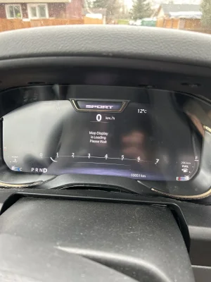

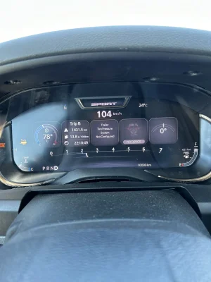

so time for real review. How are you liking the maps and the custom tiles? Was it worth it to you?
100% would do again. I've always wanted maps like that! The tiles are awesome too, I can get all my oil data at a touch of a button then go right back to looking at my new nav screen!

On a side note I have the 23 cluster running in my 18 ram 1500 currently but still working out the maps and a few other things.
It’s a hd cluster in my truck.

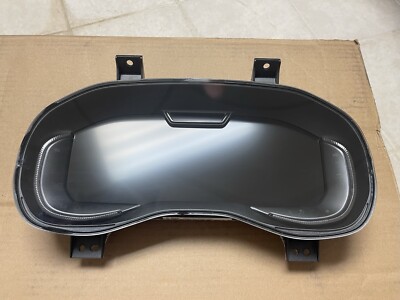

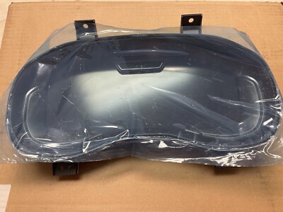

here is a digital cluster on ebay.. With shipping not a great price but also not a bad price. Ok I put my glasses on and shipping isn’t bad at all.
Here is another one from the same guy. Take that for what you will.

Here is the DJ cluster in my 18 ds .
Is it a 1500 cluster or a 2500 cluster? They are different and the 2500 cluster will not work in the 1500's
