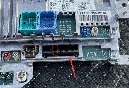

Where is the 'internet port' on the UC5? (for the small 2 prong wire from Jimmy) after getting the PITA cigarette lighter wires disconnected, i pulled the unit behind the screen out and there are a ton connections at the bottom that the 2 prong adapter could fit into. Not sure which to use? (or even if that's the right port)
the circled section below. Pretty sure it doesn’t matter which one it’s plugged into.
Where is the 'internet port' on the UC5? (for the small 2 prong wire from Jimmy) after getting the PITA cigarette lighter wires disconnected, i pulled the unit behind the screen out and there are a ton connections at the bottom that the 2 prong adapter could fit into. Not sure which to use? (or even if that's the right port) (pic stolen from ebay, but these are the only ports i see that look like the 2 prong wire will fit)
This is the one you plug into:

is it specifically that slot you circled or any one in that bank?
That’s the one the schematic calls out, although I’m definitely interested to see if someone used a different port and it works anyway (I guess it probably should now that I think about it. It’s probably just a junction bus).
What does it do specifically? (to compare if it's working or not using a different slot)
I think @OnTheReel told me that he used the one closest to the usb port and his is working as intended.
Mine is plugged in to the slot closest to the usb port but it doesn’t matter till I swap in a 23 bcm(if I take that plunge)
Yeah, mine’s definitely not in the particular slot Jimmy highlighted and it’s all good. It’s in one of the ports closest to the end. Don’t remember which end anymore, but think it’s the one nearest the USB.
