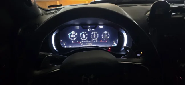

Level up is done as well!! It's definitely a little nerve wracking pulling pieces off. I plugged in the internet port but no album art as y'all explained earlier. Might be worth adding that to the write up. Also removing the trim around the cluster.
Definitely worth it for sure! Looks soooo much better. There's an option to hide the odometer too, so at least don't have to see the wrong mileage. Has anyone figured out how to reprogram that yet? I was hoping the RAM app would read the actual but it shows the cluster mileage.

I know a few people are still working on the mileage correction but nothing yet.
The album art (and map) settings are enabled in the “62014E” line in the backup file you restore to once everything is installed. The album art feature isn’t anything to write home about, but you will have it if you do the 2023 radio and BCM.

Well done! It's really a thing of beauty. One thing I wish the cluster allowed was more customization on the baja speedo, I don't need to see my tire pressure and would rather oil temp. Just need to round out the install and get the custom tiles!

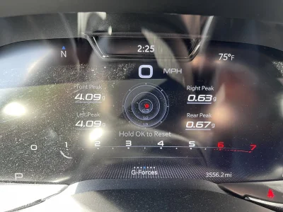

A few of the 2023’s had those high numbers from the factory. Mine did and was never in an accident. There is a picture of mine. I just reset it back to zeros.
Must be something with the 4.09…
Aw man, that makes more sense but I like my explanation more lol. Get outta here with all your logic and reason and shit!
