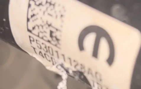

FYI - the latest OEM CV part number ending in AG is supposed to fix the problem of torn boots which lead to the joint failure. Before exploring expensive aftermarket options, it might be easier to get a set of the AG's and give them a try...just my 2c.
Hope this is true. My second boot since buying used in November, but it ends in AG!!
