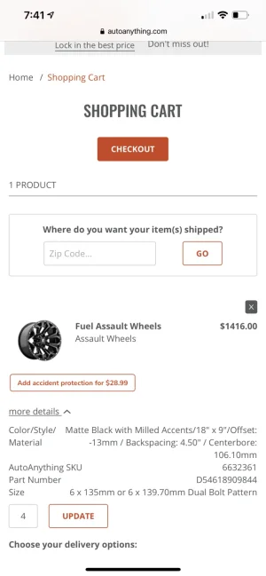

Can anyone confirm these will work w the stock tires?

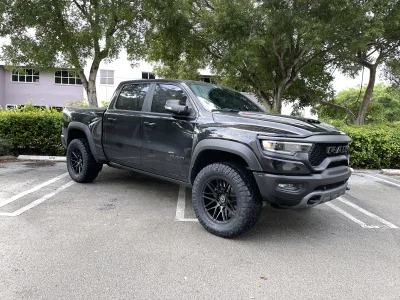

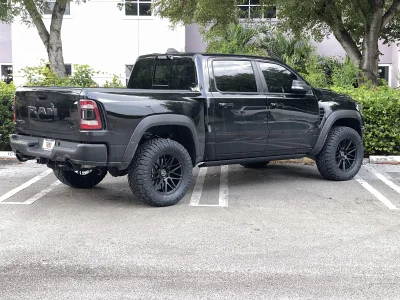

Finally on. 20x9 Velgen Forged VFT9 Et -5.
Tires: 325 /60/20 Nitto Ridge Grappler
No Rub / No Shaving / Clears Full Lock Turn
