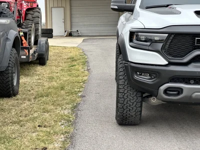

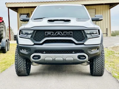

It should be fine. 37x13.50r20 cleared on factory suspension with same offset and width wheel as stock. You might have some clearance issues at full stuff if you beat on it really hard offroad, but on the street it should be fine.
You think I’d have clearance issues even with Geiser springs? I plan on doing some moderate off roading. Maybe I should stick with 37x12.50.

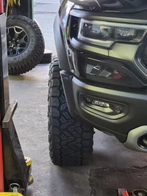

Offset will be the deciding factor. I have 37x12.5 on my stock TRX and don’t rub with pretty hard offroading.

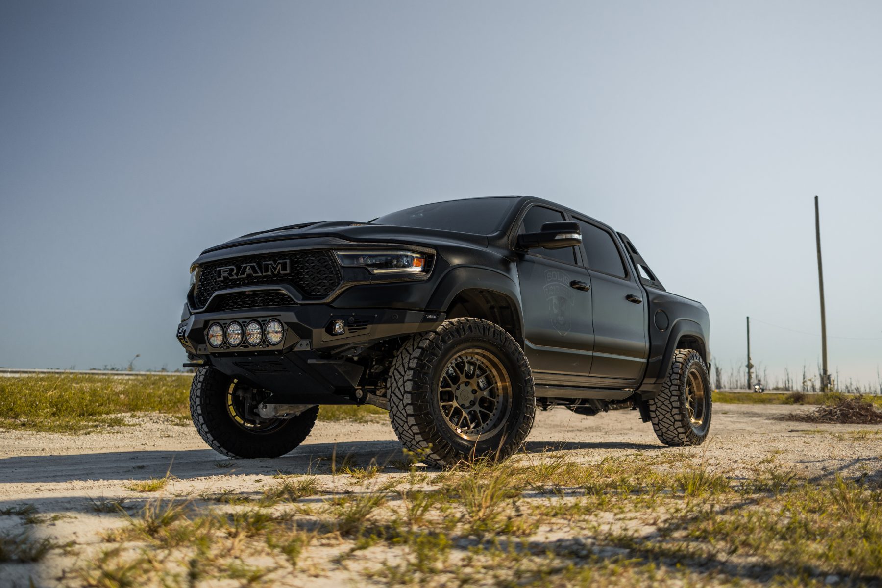

geiser springs, 37” tires

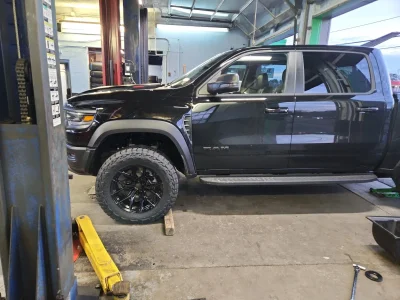

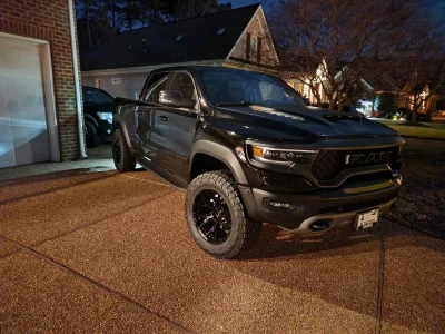

Debating between the KMC KM722 20x9 with a +0 offset or the Fuel Rebel 6 with a +18
Wrapped in 325/60/20, anyone have an opinion. Almost every time I’ve swapped truck rims it’s a +18 or +30, just don’t want the 0 to stick out but I’m more a fan of the style. Unfortunately the KM722 +18 is 8 weeks back ordered
What y’all think.
What y’all think.

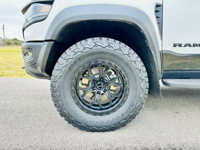

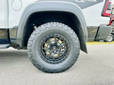

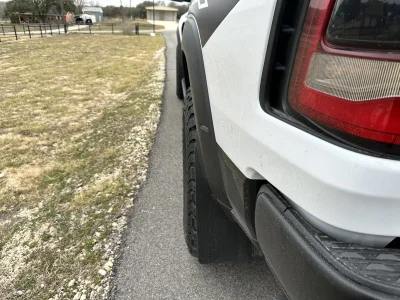

Weld ledge 6 20x9 +0 with 37x12.50r20.

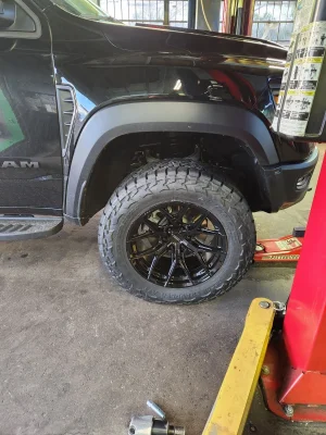

20x10 Vossen HF6-4s, -18
Nitto Recon Grapplers 35x12.5

What do you think about the recons? I’m about to order a set of vossens and debating with the recons or my favorite wildpeak AT3Ws. The recons are however 10lb less per tire
The weather has been dogsh*t, so she's a bit dirty. We'll clean her up this weekend!
Those look great. Looking at same tires and rims…. Do those fit without rubbing on stock suspension or do you have a lift?
Thanks...very happy with the result!
No rubbing at full lock in either direction. I checked it as soon as I pulled out of the shop!
