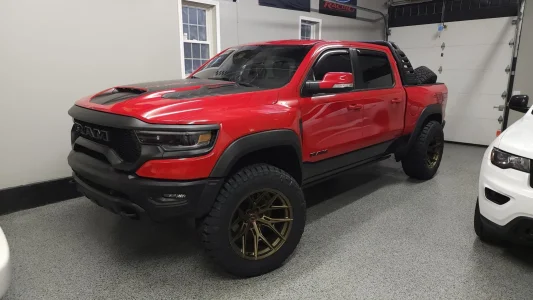

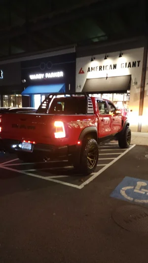

I just picked this 2021 TRX up in Florida the other day. It had these wheels and tires on it, and they didn't have the stocks anymore. It drives well and don't rub unless you're full turn, in reverse and hit a bump (Driveway curb) Does anyone have a good deal on a stock set?
I'm sure you could sell those and buy aftermaket wheel/tires for a deal.

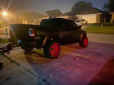

Here’s my truck with Vossen HF6-4 22x12 -44 offset in satin black
I just put 20x10 -18mm wheels with 325/60/20 Ridge grapplers on my truck(stock height) and surprisingly I have rubbing at not even full lock to the left going forward and in reverse. I had stock tires with 18x9 -12 mm wheels and no rubbing at all. I‘m pretty sure I have the TRX lean so I’m wondering if that is why I have the rubbing.

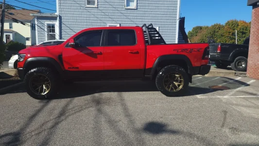

This looks awesome, any suspension mods and what tire?
Thanks. I have the Foutz 1.5 inch level upfront and .75 inch in the rear. Zero rubbing

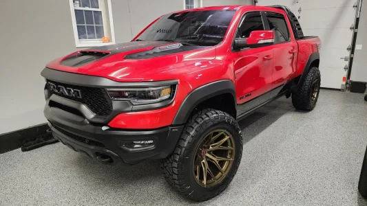

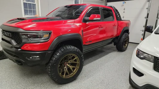

Would like to answer alot of questions I had and had trouble finding..
This is a Vossen HF6-4 22x12 -44 offset on a 37x13.50x22 nitto ridge grappler
Suspension mod is eibach front leveling springs
Springs ride great btw.
The tires DO HIT AND NEED extensive trimming to plastic. Even with trimming at full wheel lock yes it catches! mudflaps and bottom corner piece were removed and tires still catch frame at full wheel lock.
Maybe another inch lift may clear if not i believe 2 inch lift with trim will clear this setup. Im going to leave it as i love the look anyway.

Looks great, could you take a picture from the side to show the poke? Love the stance.
Looks really good! Makes me wanna do 37’s as I am on the same wheels. I’m just not wanting lots of rubbing
I’m planning to run a similar wheel/suspension setup but with 0 offset Vossen. Hopefully that won’t rub. If I’ve learned anything reading 30+ pages of this thread it’s that once you go negative offset you’re more than likely going to need to do some trimming.

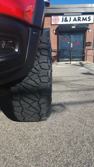

I just put 20x10 -18mm wheels with 325/60/20 Ridge grapplers on my truck(stock height) and surprisingly I have rubbing at not even full lock to the right going forward and in reverse. I had stock tires with 18x9 -12 mm wheels and no rubbing at all. I‘m pretty sure I have the TRX lean so I’m wondering if that is why I have the rubbing.
Yeah that is odd. I have that exact same set up and it barely touches turning at full lock to the left( and I mean just barely touches wouldn’t even call it a rub). No rub in any other scenario.
Apparently I’m an idiot.🤣 I’m rubbing at full turn left not right.
