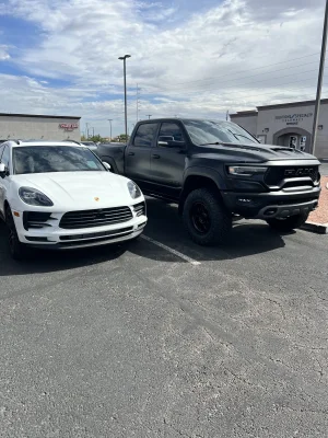

I just picked her up. I ended up going with 20” KMC 549’s with zero offset. Geiser springs Front and back. The -18 offset kept the wheels inside the wells too much. Only drive it to works so far. It is definitely a little stiffer but not too stiff. Kept the Porsche in photo so you can see the. Height.

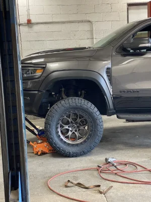

I didn’t mind the black factory rims, but I’m loving these Ledge 6’s as they go onto the truck. The 20” rim fits the wheel well nicely.
