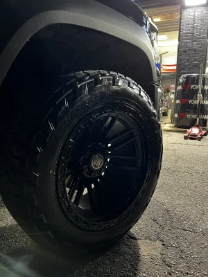

37x13.50r20 Nitto Tires
20 inch Covert Fuel Rims with a 20 offset
This is IT right here. Bad. Nice job. And no rub??? I want this setup. Already my fav wheels out there. I had no idea i could simply scale up to 37s.

You should have no rub if you stick with the +18 to +20 offset. Pretty sure the Covert comes in +20.

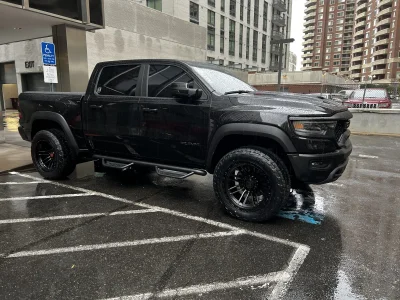

37x13.50r20 on +20 offset wheel. No rub.

As long as you keep a 9" wide wheel in the factory offset you can clear a 37x13.50 tire without having to run a level kit or some sort of triming.
