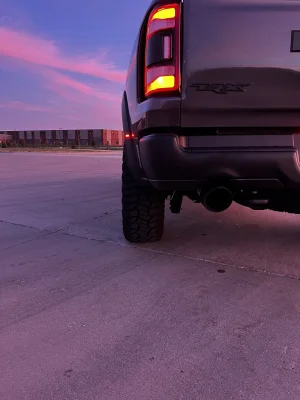

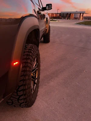

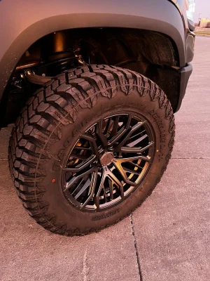

Fuel Rebel 6 in 18x9, ET-12 with Toyo 37x13.50r18 MT. Rogue perch collar kit installed without the top plate. This set up rubs, but it looks REALLY good in person. The bumper cover on the front bumper wraps around the bottom and has a "lip" to it. That had to be trimmed to clear the tire at full lock turn. The other (unresolved) issue is the lower fender flare piece at the bottom (back) of the wheel well. It rubs on the fender liner (easy to trim), but also hits the very last screw (1 of 2) that holds the lower fender flare piece on. I haven't taken it off yet to try and mess with it, but there is a small bracket behind there that the screw threads into. I'm hoping I can find a way to clearance that area a bit without it being a total hack job.

Damn that looks good! Do you think a 12.5 would clear (better)?
I don't know for sure, but I don't know that it would be that much of an improvement. The biggest rub point is really that last screw that holds the bottom of the fender flare on the wheelwell. It might help alleviate it some, but I'm guessing a little trimming will still be required. I'm hoping to mess with it more tomorrow or Thursday, and I will report back with what I come up with. The biggest issue I foresee is the bracket that the screw attaches to. That might have to get cut or somehow removed to make these clear.

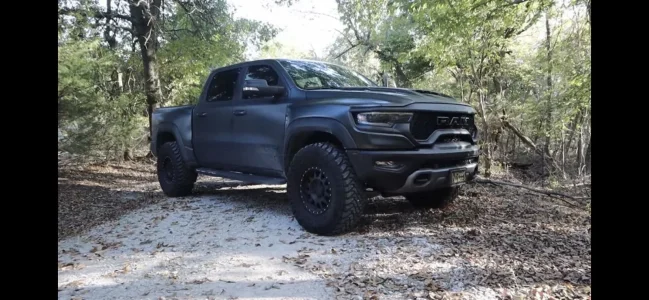

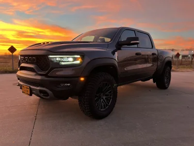

I thought it might be kind of nice to compare the two set ups I've done so far so people can see the aesthetic differences. I really like the look of the 18" set up since it shows more tire, but I'd go with a +0 offset, or ideally a +18 offset in the 18" wheel if I had to do it again. That wasn't an option on the Rebel because the +18 offset hits the brake caliper.
The 20x9, +18 offset does not rub at all with no suspension mods and a 37x13.50 Toyo MT. (First pic)
The 18x9, -12 offset DOES rub even with a Rogue Perch collar and a 37x13.50 Toyo MT. (Second pic)

ya that bottom pic looks perfect!!

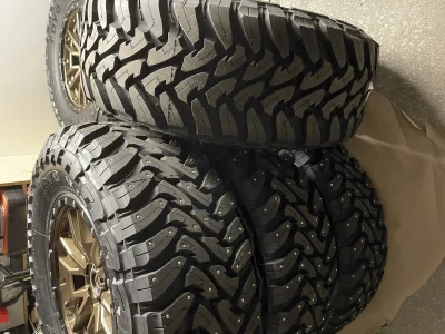

Thanks for the tips and nice pictures, I have a 2 set of 20X9, one studded and one without waiting in the garage for the truck to arrive.

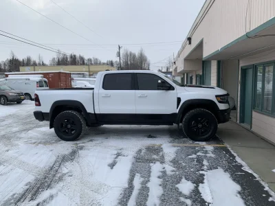

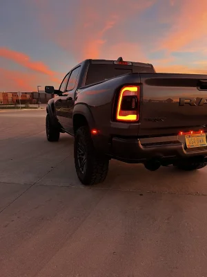

Not my truck. These wheels look great
