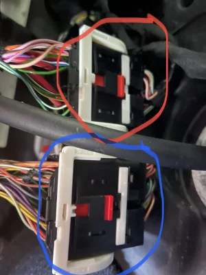

Also, mine are right above the hood release cable. It literally gets in the way when I'm plugging/unplugging. That might help too.
Another chance to get it right😀

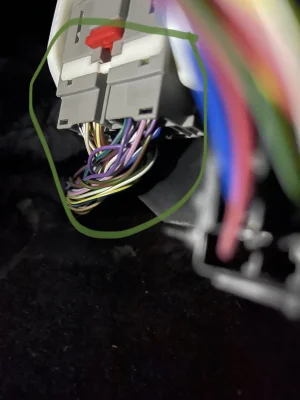

Thanks. I don’t know why I am having problems locating the plug in for the tazer.
lol, you’re not the only one. It’s a mess under the dash to begin with, throw in the awkward position you have to be in to look under it and it’s easy to get turned around.

I took off the zip tie, to show exactly how it connects and how it should look when done. Hope this helps.
