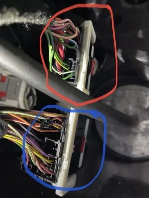

Can someone describe or take a video of the brake hold feature that was just added in the latest firmware? I think I inadvertently ran into it twice yesterday, but it was pretty alarming and want to confirm.
Which one red or blue?
Neither. The connectors you need to find have way fewer wires running to them.
Find the OBDII connector, then look about 5” to the left and straight up, further away from the firewall from where you are looking.
