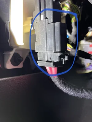

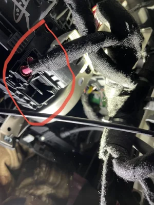

One more time please. Red or blue? Thanks
Still the wrong ones .... Follow that radiused bar up near the red circle and you should find it.
Ok. Thanks again.
Also, mine are right above the hood release cable. It literally gets in the way when I'm plugging/unplugging. That might help too.
