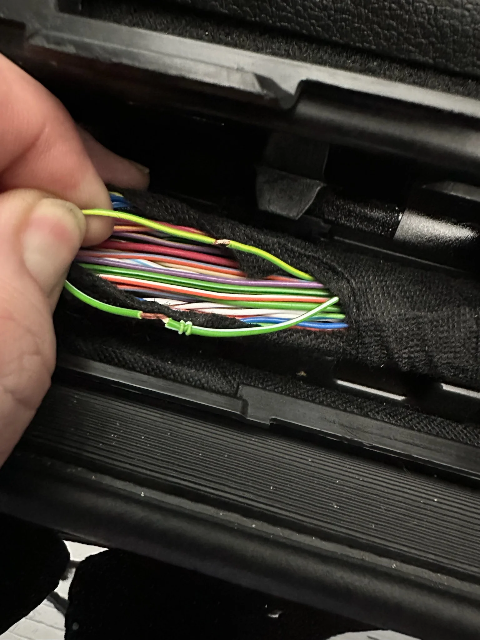

So I wired up the driver side but everytime I connect the wires I get key fob not detected. I haven't done the passenger side yet. Any ideas? I already removed my connections but it now seems my passive entry has stopped working completely. The only way I can start my truck is by pushing the Start/Stop with the key fob.
post a pic of your wire tap.
Agreed- can you send a picture please? There's like 2 dozen wires in that loom, so it's easy to accidentally grab the wrong one.

Sorry I thought the picture was attached.
So admittedly, I’m responding to this while running around this morning, so someone needs to fact check me, but I’m pretty sure it’s supposed to be the green with purple stripe wire… I think you have the wrong wire there.
