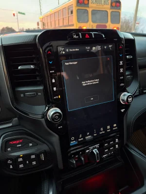

After an update about a month ago, I had the TRX engine consistently and for most part, the system was stable...starting last week, I lost the second gauge page and the RHO engine came back. It also popped up twice now with this APP update screen, takes about 5min to finish it. Not sure if anyone had this before...in short, I did a full reset, the second gauge page came back but now unable to get into the driving mode page now and again, APP UPDATE popup keeps coming back...love this...
I had this a couple weeks back and then had the radio on multiple start-ups began screeching at an uncomfortable volume until the truck was turned off or the radio was reset. This has become embarrassing that Stellantis hasn't corrected this by now @RamCares .
