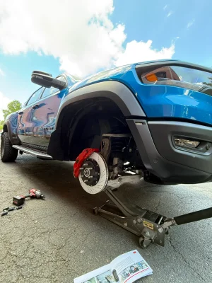

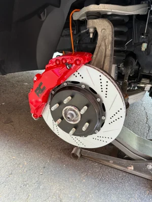

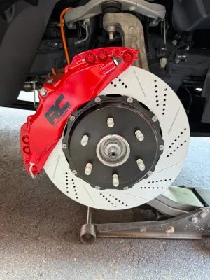

18x9 Weld Ledge(guestimate with eyeballing bracket location).
Line up the lug holes and give the caliper 1-2mm gap above the rotor and that should give a pretty good idea of fitment. From the picture it appears the rotor is sitting low on the wheel. Not looking promising for factory wheels.
What’s the rotor thickness?
32.8 So A little thicker then stock, thinner then the competition for sure.
I had it decently lined up and spaced to mentally accommodate the bracket being there. It moved for the photo but seemed to be roughly half an inch of clearance at the largest area which is more than OE and more similar to how Alcon does it. I'll take my truck apart after my hair cut today, other wise I'd have it apart already to test fit.
Hm, that’s a bummer to hear. Would be curious on the pad contact area compared to stock too.

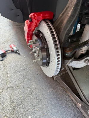

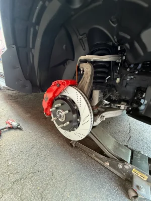

I need wheels, they don't clear my 18s. So won't be a while till i give an honest review unfortunately. They clear 18x9 -12 ledges just fine and vossens i pulled off the wall.

I remember them being similar in clearance to the weld stuff. The 18x9 0 offset RPT1 JUST doesnt clear. I am sure I could grind the caliper a tiny little bit and it would be fine but i'd rather not because these things are honestly pretty damn nice looking.
