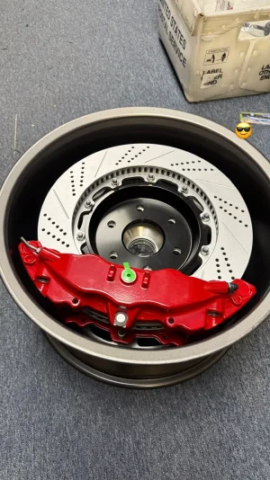

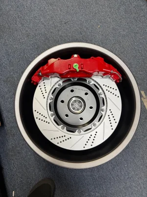

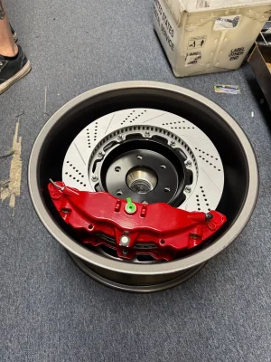

Got my kit here as of 5 minutes ago.
First round of info
Rotor is 14.8 Inches weighs 24.1 Center hat is aluminum
Brackets are steel
Caliper weighs 12.4 pounds
More to come
Stock Rotor 32 lbs
Stock Caliper with Pads 25
18x9 Weld Ledge(guestimate with eyeballing bracket location).

Keep the info coming! I need new brakes 😂
How's everything look quality-wise Nick?!
I get the ability to touch all kinds of cool parts, and I will say these give me the same wow factor as any other BBK I've opened. Printed color Instructions as soon as you open them which is rare in this world we live in full of QR codes lol. Parts look great.
