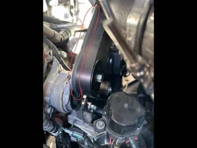

Hey Guys, I had my pulley kit installed Aug. 2/23 by my local Shop. My mechanic pointed out to me slight discolouration on the edge of my belt(see pic) after completing installation. He said the supercharger belt comes very close to the A/C compressor housing/bracket. I’m assuming that might have caused the belt to do this? I’ve been driving 3-4 days now and there’s been no issues, no smells, no noises / rubbing etc…Did anyone else experience anything like this? The truck is running great, sounding great etc..thank you @Nick797 for getting me the kit so quickly. If anyone has insight please lmk
I’ve seen where people grind off a little bit of that piece that rubs.
So yea they def should include in the instructions to grind it down a little. I ground it down after the fact by removing the belt and going back & forth w/piece of sandpaper. Took forever but I didnt have enough room to get in there w/a dremel or anything I have in my shop. I removed enough material to where i feel somewhat comfortable lol. No belt discoloration like on your end. Your belt def looks like it made contact and shaved a few 1000s of an inch off the top lol. I'd remove belt, grind down, & install new belt.

I could wrong but with the crappy Ripa squeakfest one grinding was needed as well to clear rubbing
So prior to grinding, mine didnt rub but it was dam close (like 1 sheet of crappy computer paper close). If any 1 of my pulleys backed out from factory torque by even 1-2 ft-lbs, that probably would've given the system enough play to rub the belt. Now i have like 2 sheets of comp paper (maybe 2.5 sheets). I've just added this to the list of routine checks when i do oil changes/etc (check pulley clearance + check rear track bar clearance/etc)
Hey Guys, I got the FAS pulley instructions back from my local Shop, they’re excellent instructions but I read them twice and there’s no mention of trimming the A/C bracket or trimming anything. I checked my belt and after 11+ days driving the wear mark appears to be exactly the same as when it first was installed. So maybe there was a tiny rub at first start-up and now that small portion of the belt is worn enough that it doesn’t rub anymore..? As long as it stays like it is I’m more than happy it’s a wicked upgrade👍🏻
Hey Guys, I got the FAS pulley instructions back from my local Shop, they’re excellent instructions but I read them twice and there’s no mention of trimming the A/C bracket or trimming anything. I checked my belt and after 11+ days driving the wear mark appears to be exactly the same as when it first was installed. So maybe there was a tiny rub at first start-up and now that small portion of the belt is worn enough that it doesn’t rub anymore..? As long as it stays like it is I’m more than happy it’s a wicked upgrade👍🏻View attachment 106727View attachment 106728View attachment 106729
