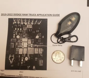

I got mine in the mail today. I'm pleased to report that the remote fob is much smaller than I expected. I'm not sure what I could take a picture of it by to communicate it's size. I don't yet have my TRX, so I can't use the TRX fob for reference. I can tell you that it's smaller than any other fob I own.
I'll try to remember to post a picture of both together tomorrow.

Here are the fob sizes for reference:
Remote is def smaller than a Ram fob. Quarter for reference. I also picked up the OBD Saver. I didn't get the model with the key lock, it looks like it would protrude out way more. This thing is well machined aluminum and the screw heads are unique to a certain bit they include as well as an 8mm driver. I think there's over 600 different security screws so no way anyone could take this off otherwise destroying the port. Shock sensor coming soon as well

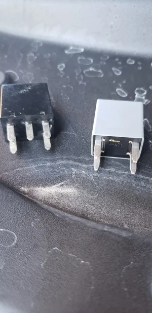

WTH he sent me a 5 prong relay . Cant insert it..I'm short a hole

Damn, mine arrived today and need to check out and make sure he sent me the right one. I put the part number in the notes.
Same..i even linked this thread.. Actually the correct part number is on the relay itself but the darn relay has 5 prongs
Mistakes happen..
BTW check your fuses/relays if they are fully pushed.. Under the dash they were aight but under the hood one relay was barely hanging
