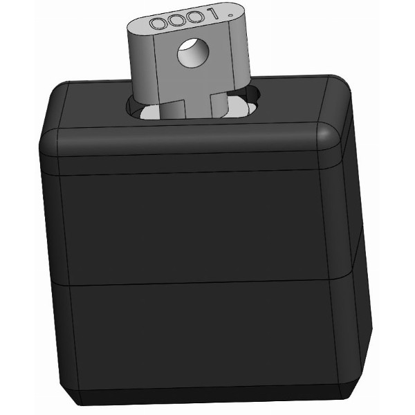

Hopefully the mobilistics helps. All part of my Defense in Depth strategy. I've also been looking at the OBD port lock that was linked in this thread, and I'm hoping someone could help me with some questions around it. In looking at it, it looks as if it screws right into the face of the OBD port. Will this damage the port? I know nothing about OBD ports, so I am not sure where contact is made. Is is the ports on the outside of the large groove? Does the large groove contain any contacts, because that seems to be where the two screws bite.
Is the OBD port easily replaced if damaged? I wouldn't mind locking the OBD port with this, but I'm worried about actually doing damage to the port.

Seemed to be decent. All metal construction with a key. On a side note I think the last security item I put in one of my cars was a Kenwood pull out. Not sure if anyone is old enough to remember those.

Someone said that the obd lock with key is too big and won't allow the cover to close . Not sure what the issue is but you guys can verify before buying
As far as I can tell, there is no cover to the port on the TRX. I think it just points downward, uncovered.
