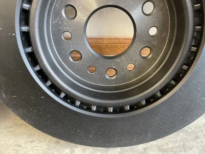

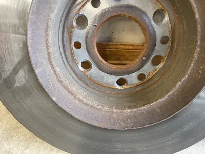

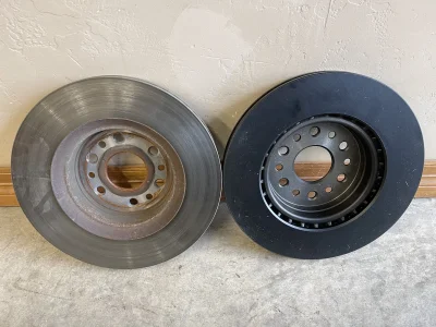

Here’s a quick write up as I was one of the winners of the contest for the rotors and new pads.
Installation is easy, although, I miss my Hellcat Brembos. Pads pop off/on in a jiffy 😜
After removing the wheel and rotor screw it is only four bolts to get the pads and brake caliper off.
After separating the pad carrier and placing the caliper on the A-arm out of the way you just replace the pads with new EBC pads.
Of note, you don’t need a C-clamp to recess the calipers. The new pads slide over the rotor and the brake caliper should just drop in. Lots of room between the pads and caliper after install but don’t forget disc pad grease or they will squeal like Ned Beatty getting raped by an Appalachian.
The rotors vs stock:

I received the rotors before the pads. I received the pads in April and finally had the time to install them together. I still have the rear rotors and pads to install but I'm happy to report that there is significantly more bite with the front done.
The stock rotors are solid castings while the EBC units have a ribbed/ventilated channel on the inboard side of the hat. Should help with heat dissipation and recover faster during spirited driving. So far, so good.
