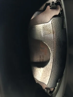

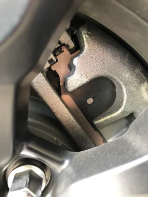

Update: Pads and titanium shims installed!

OK, I had the pads installed last week. Full disclosure, EBC sent me some shims but the brakes were already installed, missed opportunity by 1 day. Also, the dealer could not resurface my rotors like the tech said they could, so there is that as well. I always have my rotors resurfaced when new pads go on (or rotors replaced if needed). I usually replace my own brakes but the timing just sucked this time around.
My OEM brakes had a lot of meat on them still and the rotors did not have any visible grooves, heat spots or glazing.
Here is my take on the EBC pads so far:
  • They grip really, really good. I ran around some secluded streets testing them doing 80-0 mph
  • I was surprised that the ABS allowed all four wheels to lock up a few times
  • There is a noticeable amount of superior braking capabilities with the EBC pads
  • I caught myself being surprised a few times during normal operation on how quick the pads bit into the rotor and slowed the truck down
  • The pads are loud! Like city-bus type of loud (maybe even louder). I regret not getting the shims sooner and not turning the rotors like planned, because I am sure it would make some difference
Like most high performance brakes, you can expect some noise. Unfortunately, this is just too much for my liking. I am going to get the rotors resurfaced and shims installed and try it again. If they are still too noisy after that, I will look for another solution (OEM?) :(
