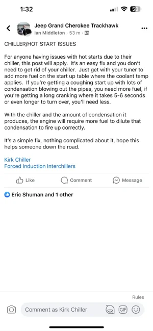

Customer who tuned and fixed the issue themselves.
As said anything that makes the intake temps colder the ambient will produce condensation.

When the system is sized properly there is no need for a tune because of excess condensate. Again we knew this was a problem and discussed with our engineers on how to prevent this. As far as I know we don't have any of our dealer/install shops having to tune customers cars because of too much condensate.
