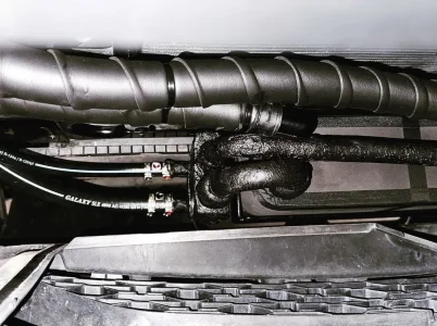

Bill and I plan to do it over Christmas break. BTW we changed it a bit so it's likely not going to be an issue with the light bar mount.
